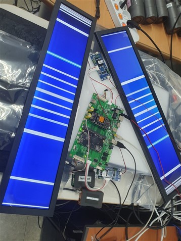

1) When RK3568 DSI Output is set to 1920x1080, the screen is displayed normally on the LCD PANEL. (However, only the top 1/3 of the 1080 screen is displayed.)
2) When RK3568 DSI Output is set to 1920x360, the LCD screen is displayed abnormally (Please refer to the image below.)
The video display timing is as follows, and the SN65DSI84TPAPRQ1 setting value is attached.

[Question]
Q1) Does SN65DSI84TPAPRQ1 not support 1920x360 resolution LCD?
Q2) If it is supported, how can I set it up to output normally? (Currently, the SN65DSI84TPAPRQ1 IC setting was done using the software tool provided by TI.)

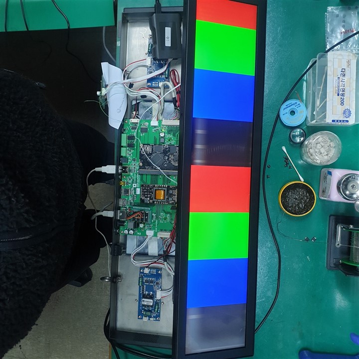

    3) If they enable the DSI84 internal test pattern, do they see the same issue?
    → [Captured picture]
    Please check. Thank you.

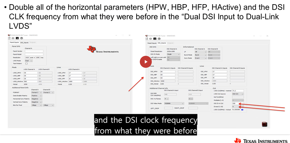

    The customer said that the LVDS CLK is 71.19MHz, not 142.38MHz, because it is connected to the LCD Panel using Dual Link LVDS.
    The LVDS CLK frequency was confirmed with an oscilloscope.
    The SN65DSI84 settings were referenced from the TI Youtube video as shown in the figure below.
    Can they please measure the line time at the DSI input and the line time at the LVDS output? The line time from the DSI input must match with the line time at the LVDS output. Please see this E2E FAQ link, https://e2e.ti.com/support/interface-group/interface/f/interface-forum/852871/faq-sn65dsi84-no-display-output-with-sn65dsi83-sn65dsi84-sn65dsi85, for how to measure the line time.
