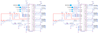

My project is using 2x SAM ICs - TCA5013 for 8 physical SAMs cards.
I have some concerns about the operation of the 2 TCAs.
Currently in the design, 2 TCA5013:
  • Different I2C address
  • Sharing SC CLK, SC IO from MCU
  • IRQ1, IRQ2, SHDN1, SHDN2 separately from MCU
Question is:
1) Can 2 TCA ICs as well as 8 SAMs work in turn when different I2C addresses? (both SHDN pins=1)
2) Can the 2 SHDN pins of TCA share 1 GPIO pin from MCU ?
3) If TCA5013 enters shutdown mode(SHDN=0), what are the states of the SC CLK, SC IO pins? high-impedance ? Will it affect the remaining TCA5013(CLK/IO) if I shutdown 1 of the 2 TCA5013?
Here is my schematic for 2x TCA5013:
Kindly review and let me know your valuable comments. Thanks a lot.

  • HI VietCuong:
        yes it can be 8 SAMs for two TCA devices with  different I2C address.
     works only if SHDN is always high
    in SHDN mode, only card insertion detection circuitry still works all other IOs are shutdown..
    If you share SHDN pin, how can you control which TCA to shuntdown.
