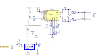

TSS721A: This IC is not communicating with Micro-controller
Part Number: TSS721A
I am using this M-Bus slave IC. As per the below allachment, I am giving the Tx pin output (of IC) to the photo-coupler(H11L1) through the PNP transistor. At the outout side of Photo-transistor, always high signal is appearing and it is not getting low even after switching at Tx pin of IC can be seen. Please look this issue.
Also please share the maximum output current of VDD pin pf IC in below condition:
1. RIS - 50 ohm
2. SC - 100 nF
3. RIDD - 15 kohm (30 khom also tried)
4. STC - 220 uF.
