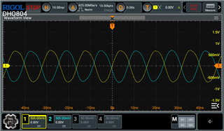

I measured TD and RD signals (on connector pads, after decoupling capacitors) without connecting a SFP transceiver (not sure if is the right procedure), and got this constant waveform on RD+, RD- which seems similar to datasheet figure 7-20
TD+, TD- are both constantly 0V even when MAC sends packets.
Does this behavior make sense? I would appreciate any guidance or related material I can check to know how to isolate the issue.

  • Hi Fiorella,
    Thanks for confirming and sharing the register dump. The behavior shared in the waveform is expected, but TD+/- not transmitting is a symptom of link down.
    The register configuration appears valid for Fiber 100M. If applying a soft reset to the PHY through registers does not bring link up, the issue is likely with the schematic or layout. I will review when shared.

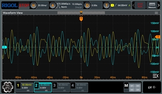

  • Hi Evan,
    A short update on tests: I just realized that somewhere on the code there was an initialization function which forced MDIX by default, with register 0x19 ... so actually it was the TD+- pair that had the active signal, and RD+- is 0V (small noise around 100mV). I've disabled it and I'm using a clean code just to read the registers now, but I still can't get a link up from phy or switch.
    Another thing that noticed is that sometimes after a power up, SD_EN would show a square wave instead of constant 3V, about 20% duty cycle. This has happened only twice almost randomly and I'm still figuring out the conditions to reproduce it. Do you have any idea why this happens? Could it be related to link issues?

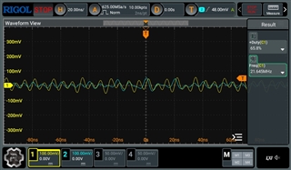

  • Hi Evan,
    Thank you for checking the schematic
    Unfortunately, I don't have the 822EVM.
    Here are some notes about last tests:

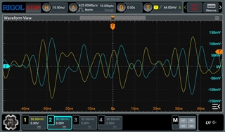

    • Signal Detect only shows that behavior when connected to a specific SFP transceiver (Flexoptix S.1303.2M.IG). Even if it is just the SFP alone, without fiber cable
    • When other transceiver or no transceiver is connected, there is a smaller amplitude noise, and SD stays high
    Here are some captures of RD+- noise with Flexoptix SFP
    SD signal on yellow and RD- on blue
    RD+- noise with other transceivers
    I would appreciate your comments and suggestions.
    Fiorella

  • Hi Evan,
    Apologies if my previous responses led to confusion.
    Yes, in all tests the SFP modules are the same at both ends of fiber cable.
    I did reproduce the conditions to 20% square wave in Signal Detect (Pin 24). The behavior occurred only when connecting the transceiver: Flexoptix S.1303.2M.IG. And the same signal remained with and without connecting a fiber cable or link partner. Just the empty SFP generated the wave as you can see on the images of my previous response.
    RD+- particular noise shown on the first 3 pictures above, also occurred only with Flexoptix SFP
    When that is not the case, and 20% wave is not observed:
    • SD pin is always high at 3V, due to pullup resistor (R71 in my schematic and R73 on EVM)
    • RD+- smaller noise is also shown on last image
    • This happens when there is no SFP connected and also when using other SFPs different than Flexoptix.
    • Same behavior whether link partner is connected or not.
    I'll request the SFPs you mentioned but probably will take some time to arrive and test.

  • Hi Fiorella,
    Based on the current signal and register results, my conclusion is that the PHY is configured is correctly for fiber, but there is some hardware issue with the board, SFP module, or link partner causing RD to be significantly attenuated.
    When probing TD+/- of the link partner, do you see signal with similar amplitude as TD+/- from 822? Is it possible to probe along the path for this signal to isolate where the attenuation is occurring?
