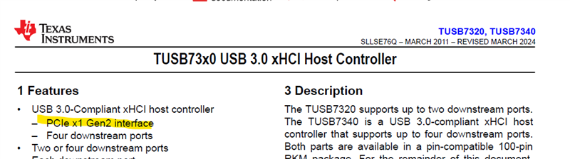

Hi Brian,
One more question.
The TUSB7340I is connected to PCIe x1 Gen2, and then connects to 4 USB3 GEN1 ports. I would like to confirm the following:
Thanks!
Jeff
Hi Jeff:
USB3.1 speed is 5Gbps, but USB3 is 8b/10b encoding so the actual speed is 4Gbps. all 4 downstream ports will share 4Gbps bandwidth , plus other payloads, the actual throughput for each port should be less than 1Gbps.
