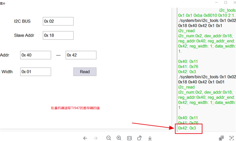

The issue with 947 is that our company experienced a failure during the experiment of engineering change.
1. Two units failed in the cold and hot cycle experiment. Based on the current analysis of the problem, the experimental issue tends to be related to TI947;
2. Compared to the previous batch machines, the experimental machine's reading of the TI947 register value is different;
3. The value read by the experimental machine from the TI947 register has discreteness.

    The registers that are being read here are from indirect access, specifically the OLDI Page.
    • From the images, it appears these reads are the same (is the image accidentally uploaded twice?)

  • 6 experimental samples, 2 of which malfunctioned;
    Phenomenon 1: During the cold and hot cycling (cycling in the range of -30 ℃ to 80 ℃) test, the sample shows no backlight on the screen (appearing in the 80 ℃ range), and the temperature will return to normal when it decreases;
    Phenomenon 2: When the sample is cycled between -30 ℃ and 80 ℃, there is a phenomenon of no backlight on the screen during startup at -30 ℃; The gradual increase in temperature is the elimination of the fault;
    After assisting in replacing one 947, the fault disappeared but did not reappear, and the fault followed 947.

  • 1. When there is a problem, the backlight can be seen to be bright, and it also has a touch effect; It's just a display issue; 2 a、 The problematic machine replaced the surrounding materials of the 947 circuit once and re experimented, but the experiment still reproduced; b、 Comparing the values read from the register of 947, it was found that the machine with the problem is different from our batch shipment status machine; c、 After turning on the machine normally and creating an environment of 80 ℃, if there is a phenomenon of no display, it will be restored to normal display when it is warmed up again; The problem of returning to 80 ℃ has reappeared
