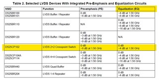

Hi, I would like to know the gain in dB when enabling Pre-emphasis and Equalization separately.
I have attached a similar data from the datasheet of DS25BR120.

This device is quite old (released in 2008) and I do not have the original design information. I was able to find the following table in a previous E2E thread.
