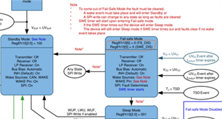

Q3: Is the description of the register address in fail-safe mode in the figure below incorrect? Reg8'h10[6] = 0 (FS_DIS) is a typo of Reg8'h17[0] = 0 (FS_DIS), and Reg8'h10[5] = 0 (SWE_DIS) is a typo of Reg8'h1C[7] = 0 (SWE_DIS).

    3. Yes it is a typo
    4. FS_DIS need = 0 to enable fail-safe mode, however the SWE_DIS won't affect the transition of fail-safe mode. SWE_DIS can be disabled by set to 1, then the SWE timer will not start in fail-safe mode.
