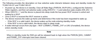

  • Hi Shrinidhi,
    That 2 seconds time period would be too long, so the low power receiver is deactivated. Please note that a valid WUP (can be any CAN frame) is needed to trigger the receiver monitoring WUF. If a WUF is not detected before tSLIENCE timer expired, the WUF receiver will be inactive and you need to send a WUP again, followed by a matched WUF.
    Sean
  • Hi Sean,
    • Even if we send a WUP again, followed by a matched WUF, we don’t wake up. Cantrcv is stuck in some state after Step 4 to Step 5 from the above ticket description.
    • Irrespective of timing, if we don’t send Non-WUF first followed by WUF, the issue is not observed, and every time we wake up.
    • Why does the issue happen only when the Non-WUF is sent first followed by WUF? What causes Cantrcv to get stuck and not be able to wake up even with the valid WUP and WUF?
      You can find the trace screenshot 0x555h WUP and WUF (0x500h)
    Br,
    Shrinidhi
  • Hi Shrinidhi,
    Did you sent the WUF “immediately" after Non-WUF? Or still having that 2 seconds delay?
    A WUP (or any bus activity) is required to enable the selective receiver in sleep mode. This is because the selective wake receiver consumes more power than the low power receiver, so the selective wake receiver will remain off until bus activity is detected.
    Is it possible to capture waveforms of the CANH and CANL signals during this test? Let's consider two different cases:
    step 2: Only one WUF is send and successfully wakeup.
    Is there any bus activity before sending the WUF? My guess is the controller can actually sent not only one frame, it is possible that the controller send the WUF again if no ACK bit is received, thus can you please capture the CAN bus waveforms, along with the INH output?
    step 4 and 5: WUF is send after a non-WUF, but no wakeup.
    Again, please capture waveform I mentioned above, it is possible that the controller actually didn't send the WUF, it continuously to send non-WUF due to not receiving ACK bit, then the WUF is never detected.
    Sean
