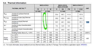

I am looking for the thermal rise information for SNJ55LVDS32J.  Are thetaJC_top and thetaJB available?

    Here are the results:
    Result- Theta JA-High K (standard datasheet value) 84.1
    Result-Theta JC, top (standard datasheet value) 48.2
    Result-Theta JB (standard datasheet value) 72.5
    Result- Psi JT (standard datasheet value) 37.7
    Result- Psi JB (standard datasheet value) 68.9
    Result-Theta JC, bottom (standard datasheet value) 24.3
