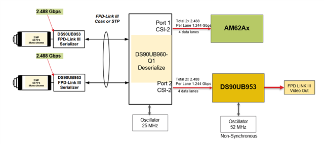

I have some queries regarding this architecture:
Q1. We are using different crystals/oscillators for this architecture individually. Is this acceptable, or do we need to synchronize the same clock for this application concerning the DS90UB953( Non-synchronous).
Q2. Is the structure for video output appropriate?
Q3. Can we compress the  Port 2 CSI-2 upto 832 Mbps per lane for DS90UB953 compatibility
Q4.How do both camera data streams come on MIPI CSI-2 in term of packet or media
    Please find feedback below:
    1. As long as the devices are operating in non-synchronous mode, using a separate oscillator for each FPD-Link device is acceptable.
    2. Can you clarify what you mean by the video output structure? If you are talking about the system architecture of a deserializer CSI port being fed to another serializer, this is okay as long as the bandwidth of the receiving serializer is not violated. Please note that the receiving serializer requires a partner deserializer.
    3. No, the 960 CSI ports operate at fixed nominal rates. The port can only operate at 400Mbps, 800Mbps, 1200Mbps, or 1600Mbps per lane.
