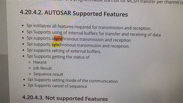

My customer is using TCAN4550-Q1 and IFX MCU with AutoSAR MCAL. They want to use MCAL asynchronous SPI to communicate with TCAN4550-Q1. Can TCAN4550-Q1 support asynchronous SPI? Thanks!

  • Hi Jonathan,
    Thanks for reply. Asynchronous SPI means non-blocking SPI, a method of communicating using the SPI protocol where data transfers happen without blocking the main program flow, meaning the microcontroller can continue executing other tasks while the SPI transfer is in progress.

  • Hi Grey,
    Then this seems to be a question of the MCU capabilities rather than the TCAN4550.
