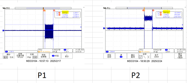

    Problem: When the load resistance is adjusted to a few ohms to 40 ohms, the waveform measured on the load resistance is shown in Figure 1.
    At this time, it is in a short-circuit state. After the TIOS1023 FAULT signal is pulled low for 6us, we turn off the output. It feels that the output pin is constantly switching before the TIOS1023 FAULT signal is pulled low.
    Figure 2 is the waveform when it is adjusted to 50 ohms or below 1 ohm. The waveform state is normal.
    May I ask what is the cause of the phenomenon in the waveform in Figure 1?

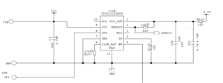

  • Hi Jonathan,
    Refer to this part of the circuit, the 0Ω resistor of R110 is not connected, EN pin is connected to high level, so that OUT is in the output stage,
    For short circuit test, add a small load resistor between VIN and OUT pins, and use a sliding rheostat.
    Note: In actual test, no matter what voltage value VIN voltage is at, or whether it is NPN or PNP mode, the phenomenon mentioned above will be observed

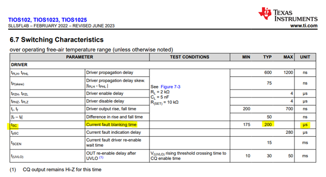

    The TIOS102x has a current fault blanking time of approximately 200uS before it will disable the OUT pin driver.  During this time the device will only have the current limit detection and feedback loop to try to adjust and limit the current flowing through the driver.  Because this is a feedback loop, it is possible to have some complex loading from the inductance of the wires, resistance, and capacitance on the line that may setup some phase differences that result in oscillations.

  • Hi Yahui,
    In theory I also don't think this is a problem that would cause damage to the chip and the waveforms from the customer do not show excessive current.  The device itself is capable of at least an amp of current through the bond wires and what I see in the waveforms appears to be a current level fluctuating between the regulated limits with the device's current loop changing between a heavy regulated to lightly regulated levels as a result of the phase delay.
    In both the P1 a P2 waveforms provided, the duration is only about 200uS which is equal to the Current Fault Blanking Time when the driver is completely disabled as a result of the overcurrent condition.  This is still functioning correctly and is the primary safety factor in the result of a short circuit event.
    Because the fault detection is still working properly, I would say this should be comfort that there is low risk to the device becoming damaged under these conditions.
