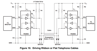

I am planning to use I2C bus going between 2 boards that are ~1m apart. Also the source signals are at 5V and destination is at 3.3V. I am looking for a buffer and a level translator.

    The P82B96 can be used as a pair for long distance cable I2C applications.
    However, 1 meter is not that long. You might be able to use a single buffer device such as TCA9617B with the A-side facing the long cable length.
    For TCA9617B application, VCCB = 5V, B-side facing source side, and VCCA = 3.3V facing the destination side.
    The TCA9617B will be cheaper.
