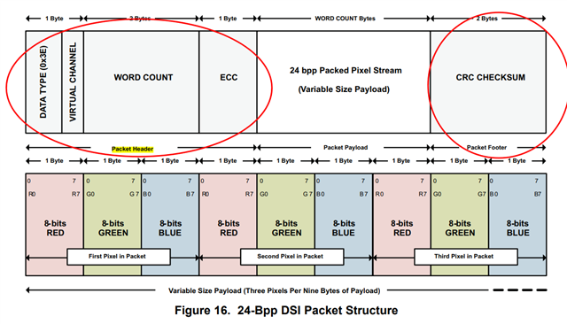

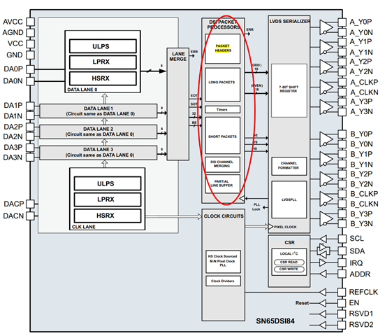

    Below just is an idea from customer. Customer found that there is the DSI packet processor inside DSI84.
    And DSI CRC information is in the packet footer based on DSI specification.  DSI84 correctly decode the DSI packet of the incoming streams and get the CRC checksum then check it for CRC error detection. Is it right?

    To detect possible errors in transmission, a checksum is calculated over each data packet. The checksum is realized as a 16-bit CRC. The DSI84 will use this to check against the CRC being included in the received data packet and flag an CRC error if the calculated CRC does not match with the received CRC.
    Ikram
  • HI Ikram
    So the job that a checksum is calculated over each data packet is done by DSI84 itself, is it right?
  • Yes Ted, this is done by the DSI84 itself.
