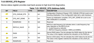

  3. Read deserializer register 0x04:  Received 0xCF

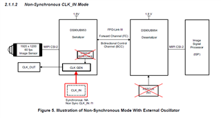

  • Hello Puneeth,
    Deserializer has no external clock
    The deserializer requires an external clock for normal operation. Can you feed an external 25MHz clock to the deserializer?

  • Hello Puneeth,
    The 954 deserializer MUST have a 25MHz clock fed into its XIN/REFCLK pin. Below is an excerpt from the DS90UB954 datasheet on ti.com.
    I don't recognize the Figure that you shared, but the latest version of the dataasheet states that the 954 device MUST use a 25MHz oscillator. The SER/DES devices will not be able to operate properly unless you apply this 25MHz clock to the deserializer.

      • Deserializer Register 0x04: Shows 0xdf (which indicates an issue).
      • After manually configuring the PLL on the serializer, the deserializer immediately locks.

      1. If register 0x04 = 0xDF in the 954, then this indicates no issues. All the correct bits are set.

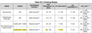

    4. In the serializer, since you are setting register 0x05 = 0x13, you are setting the CLKIN_DIV bit to 1. This means you are enabling a clock divider that is dividing the REFCLK by 2, which is reducing the Forward Channel rate from 4Gbps to 2Gbps.

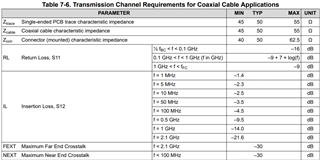

      1. If you can only get LOCK when the FC rate is reduced, then this indicates that there is a violation in the IL/RL limit lines for the high-speed traces. Below are the requirements for the entire high-speed channel (PCB+Cable+PCB).
      2. Have you measured or simulated the IL/RL of your high-speed channel?
    5. After LOCK, if you cannot read any I2C registers in the remote serializer, then this also indicates excessive loss issues. I2C is a bidirectional control channel. If the high-speed channel has high loss in the lower or upper frequency ranges, then I2C bits may be lost, which can cause failed I2C commands.
      1. Are you able to provide Insertion Loss or Return Loss data for either the entire high-speed channel or just the PCB?

      • LOCK happens only after setting register 0x05 = 0x13 on the Serializer (953) or if we change  serializer clock from 50Mhz to 25Mhz

    5. We do not have access to a Network Analyzer for measuring return loss and insertion loss. Are there any alternative methods you recommend for diagnosing and solving this issue?
    6. I2C Back Channel Issue:
      • After achieving LOCK, I still cannot read registers from the remote Serializer (953).
      • Could this be directly related to excessive loss in high-speed traces, as you mentioned?
      • Would adjusting EQ settings or pre-emphasis help mitigate this issue?

    3. I2C is a bi-directional protocol. If you have stable FC established, but there are issues in the BC, then remote I2C commands may be lost. The suspicion is that there is some violation in the S-Parameters at the lower MHz range if I2C commands are not being sent.
    4. The cable is 0.3 meters. A very short cable can cause high Return Loss.
      1. There is not a way to confirm the IL/RL in the system, unless you use VNA equipment to measure S-Parameter. You can potentially reach out to the cable vendor to see if they can help provide more information.
