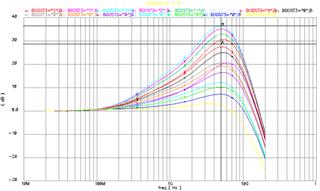

My customer is trying to figure out how good the CTLE on this part is. Do we have any information/data on this?
Their use case - traces < 10 inches with airmax connector in between

Hi Abigail,
IN0 equalization curves from bottom to top it goes from EQ of 0 to N.
Nick
Thanks Nick! I'm checking with the customer to see if this has resolved his question
