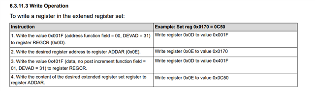

  • Michael
    To double check, these are extended access registers. Did you use the below procedure to write to these extended access registers?
    David
  • Hi David,
    Thanks for the tip. With the adjustment, the read and write functions work! Unfortunately, I've noticed that the measurement isn't 100% reliable.
