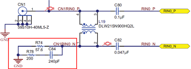

DS90UB964-Q1EVM: Regarding Common mode choke and FPD link input circuit
Part Number: DS90UB964-Q1EVM
Hi
We got two questions regarding the EVM circuit.
1.  the purpose of R78 and C84 of the EVM cirucit which i extracted below . In the datasheet, it is asking input 50 ohm termination resister, is the circuit indicated in red box below equivalent to 50 ohm termination resistance?

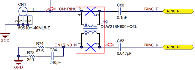

2. if we would like to add common mode choke, do we need to cut the trace indicated by blue cross lines below ?
