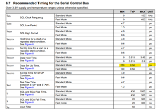

Hi team,
for I2C Data setup time, could you please confirm the unit (ns? or us?) and the spec (560ns? or 0.56us?)
Youhei MIYAOKA
Part Number: DS90UB925Q-Q1
Hi team,
Youhei MIYAOKA

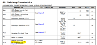

Hi team,
Could you please check on bit error rate expected, if it should be Bit error rate≥10-10 or Bit error rate≤10-10?
Youhei MIYAOKA
Hi Youhei,
Let's me investigate this, and I will get back with you.
Aaron
Hi Youhei,
I reviewed and compared between different datasheet. It seems this is just a parameter when they measured the data. In my opinion, it should be BER <= 10e-12.
Regarding to the setup hold time, The I2CV is fairly standardize specs. I don't think 560ps is a valid number. Most of other datasheet doesn't specify the typical value. I would think the value is 560ns not .56ns.
Aaron
