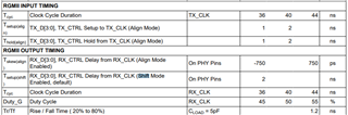

  2. what is the differences between  RGMII (TX and RX Internal Delay Mode) and  RGMII (Align Mode)?

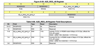

  3. if I set dll_tx_delay_ctrl_rgmii_sl =5ns by MDIO way, is there any problem?
    See RGMII output timing for more information. RGMII align mode means there is -750 to 750 ps of skew on the output clock, whereas with RX or TX shift mode enabled, (Internal delay mode) you see a 2 ns delay added.
    A minimum of 1ns setup and 1ns hold time must be maintained at the input of the receiver. By default, the value is 7 * 312.5 ps =~ 2ns see dll_tx_delay_ctrl_rgmii_sl and dll_rx_delay_ctrl_rgmii_s. I don't know if there would be a problem with 5 ns but it is generally not recommended to use the device in this way.

  • Thanks, for most questions are clear for me,  and if cfg_rgmii_tx_clk_shift_sel=1? then there is 2ns delay, and then if dll_tx_delay_ctrl_rgmii_sl=2.5ns, what is total delay ? 2+2.5ns?

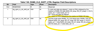

  • May I know if I plan to set RGMII (TX and RX Internal Delay Mode)  RX_D2_strap, RX_D1_strap, RX_D0_strap} ==3'b110
    with default delay setting, do I need to set  cfg_rgmii_tx_clk_shift_sel?
    below description said use this mode when RGMII_TX signal are aligned, so I think RGMII (TX and RX Internal Delay Mode)  does not need to set this register.
    How to understand below logc description?
    reset_val = 1 else if({RX_D2_strap, RX_D1_strap, RX_D0_strap} ==
    3'b110) reset_val = 1 else reset_val = 0
    No, it is more like one or the other. You can increase the delay using the delay register, but the default that you get from enabling the shift register is 2ns.
    See this image.
    RX_D2 is MAC[2], RX_D1 is MAC[1] and RX_D0 is MAC[0]
    reset_val indicates the value of the register after turn on. A reset_val of 1 means the bit is activated. The logic indicates what the pullups straps do to the register on power up.
    For example, to enable TX and RX internal delays. Pull RX_D2 high, pull RX_D1 high, and leave RX_D0 floating. (MAC[2] =1) , (MAC[1] = 1), (MAC[0] = 0). See the table above.
    If you use pin strap control to enable the delay in TX and RX you do not need to set the shift register because it will already be set. You also do not have to set the delay register unless you want a longer or shorter delay for some reason.
