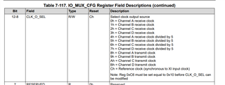

We want to synchronize the frequency between devices using SyncE function.
I know that the CLK_OUT pin setting can be changed in register 0x170. But there's no option to output SGMII port clock.
Can the output clock of DP83869HM be recovered in bridge mode?
If so, how should I set the register?
