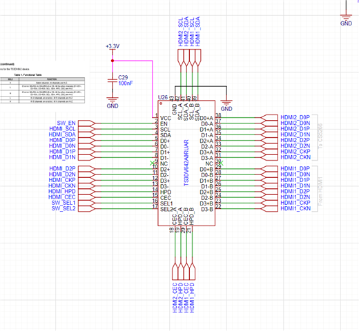

TS3DV642: Differential line swapping
Part Number: TS3DV642
I am using the HDMI port as a sink port. I can see the EVM of TS3DV642A0RUAR matches the data lane distribution, which is smooth, but in my design, it requires crossing the lines and use vias. Can I simply swap the line for both side and using any of Data pins for matching the line? (Or the pin roles is fixed and if it is related to D0 , only D0 can be connected for all pins?)
