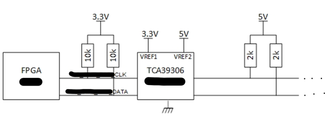

Hello everyone,
I am currently working on simulating an I2C bus at a frequency of 100kHz, and I need some guidance. My objective is to integrate the IBIS model of the TCA39360 in order to level shift the signal from +3.3V to +5V between my transmitter and receiver.
However, I am unsure how to implement the IBIS model in conjunction with a series switch in Ansys Electronics 2022. Could someone please assist me in understanding how to incorporate the IBIS model into my simulation?
Additionally, I would appreciate any insights on whether I should use the 1P5, 3P3, or 5P0 model for this application.
Thank you in advance for your help!
  • Hi Luna,
    Sorry for the late reply.
    I am not familiar with that testing software. Is there anyway you can provide a schematic?
    For the IBIS model, the 3p3 model should be okay to use.
    Tyler
