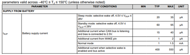

Hi team,
Our customer is considering TCAN1465-Q1 and they want to estimate its max current consumption in sleep mode. Could you check if below calculation/behavior is correct?
In Sleep mode (LP Receiver: On):  max 35uA+40uA = 75uA
- After receiving WUP, device went to WUF identification, and max 35uA + 550uA = 585uA
- When WUF matches, device moves to normal mode
Thank you,
Muwei Zheng
