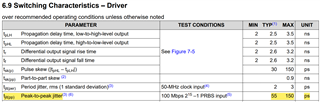

When input the clock to the SN65MLVD204A,  is it possible to change jitter(tjit(pp))?
Driver spec on "9 Switching Characteristics" describes 55ps(TYP)、150ps(MAX).
For example, If SN65MLVD204A drives 10kHz clock(Duty50%) and 10MHz clock (Duty50%), does it causes the difference on jitter(tjit(pp)) of clock?
If yes, do you show the estimation for the difference on jitter(tjit(pp))?
In my opinion, the jitter might be change due to line impedance , the slope fo rising / falling edege and signal bit pattern chage the jitter.
Is it possible to estimate the tool like IBIS model?

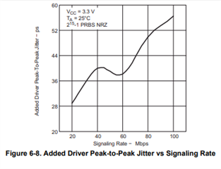

    Page 10 of the SN65MLVD204A datasheet shows a graph you can use to estimate the added peak-to-peak jitter based on your clock frequency.
    You can perform simulation using the IBIS model to generate an eye-diagram to estimate jitter.
