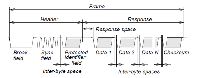

LIN comms format is also different from RS485/UART. The following is the LIN frame as reference.
So MCU is needed here to process the message.
