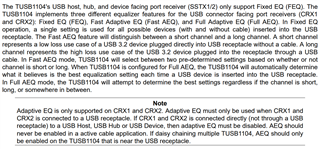

    The most important pins in AEQ mode are as follows. These will enable/disable AEQ and determine the max EQ that AEQ can go up to.
    The AEQ process is as follows:
    The time to achieve the best EQ setting will always be lower than 400us. If outside of this range there has been an issue in the setup and configuration of the device.
    The AEQ will only apply to the connector facing pins. The host facing pins will have fixed EQ still, as this path will be set in the PCB.

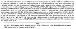

    Here is some more insight into AEQ from the datasheet:
    There is no optimal setting that will work across all boards. Redrivers must be tuned for each application they are used in. The key contributors are insertion loss and ISI. Each system will have different levels of these parameters. I recommend keeping the settings as follows.
    SSEQ0/SSEQ1: this will be tuned based off of your PCB design.
    AEQ: Enabled
    AEQCFG: set to max value (PUP)

  • Hi Sawan,
    This is defined in the image below. This is from the datasheet. If its longer than 400us, then there may be an issue as it exceeds the maximum time listed in the datasheet.
