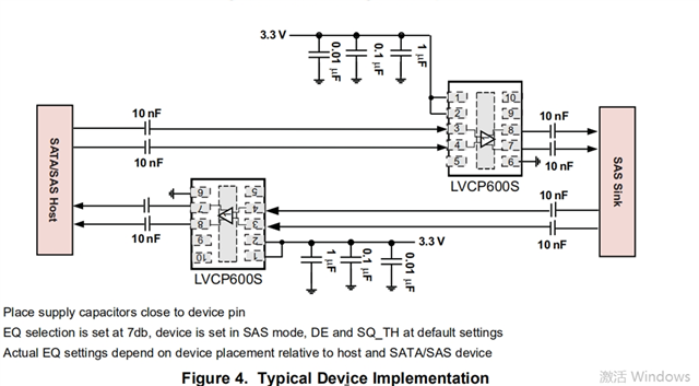

Could I use SN75LVCP600 as SATA3.0 redriver?
Customer need 2 SATA signal chain used in same time.
Is it possible to insert the chip onto the link as shown in this diagram?
Is there any additional design guidance and recommendations and considerations?
