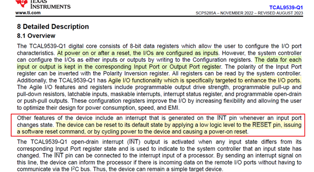

Q2: In DS 8.1: “The device can be reset to its default state by applying a low logic level to the RESET pin, issuing a software reset command, or by cycling power to the device and causing a power-on reset.”
Does this will influence external loads’ states? Or just influence internal registers?

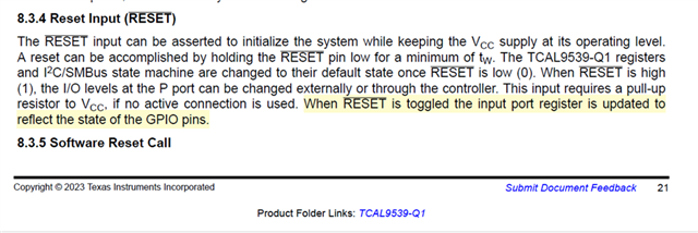

Q3: In DS 8.3.4 : “When RESET is toggled the input port register is updated to reflect the state of the GPIO pins.”
Why there is only “input port register” to be updated but no “output port register” to be updated? Is it because all I/Os will be set to inputs at reset?
    The three ways of resetting the device will influence the internal register states which will influence the configuration of the I/O side. The default state of the I/O pins is configured all as INPUTs.
    This is correct. Upon /RESET command to the I/O expander, the I/O's will all be set to their default state which is high-z inputs at reset. Outputs are no longer configured.
