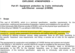

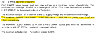

Hello support team,
My customer is looking for designing at MDI interface.
And they are studying DP83TD510E and our app-note SLUAAA9A.
How could they meet IEC 60079-47's Co<5uF and Lo<10uH requirement?
The suggested circuit is that the DC block cap Co:0.22uF+0.01uF/2 & Lo :2.2mH.
