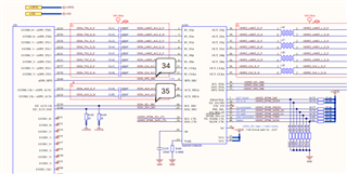

Dear Support Team,
I am contacting you to ask if the SN65DP159RGZR supports DP?
We are thinking to implement such a configuration but with DP on the input instead of DP, would this work?

No, DP159 is a DP++ to HDMI passive level shifter. For DP to HDMI, you would need an active protocol converter and unfortunately we do not have it in our product portfolio.
