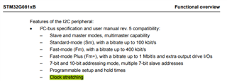

    Is it the STM32G0 devices that are clock stretching the bus? What is causing that device to hold the SCL line LOW for that long?
    I looked up STM32G0 datasheet and couldn't find much documentation on the nature of its clock stretching, although I found one section that says it supports it.

  • Hi Tyler
    Thankyou for sharing the features of STM32G030,
    Yes STM32G030 device is stretching the clock line low.
    We are trying to free it up from ESP32-S3 master side but slave device is not releasing the control, until resetting the device manually.
