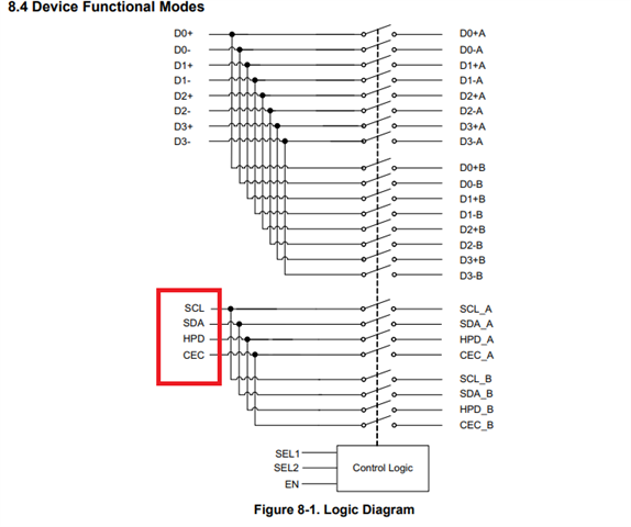

HI sir
could I use the SCL/SDA HPD/CEC to be the mux?
Q1:Can I use the SCL/SDA HPD/CEC be the different input x2 ,and different out x2 ?
Q2:SCL/SDA/HPD/CEC ,may i know the max speed is GHz? Dn is 3GHz,how about the SCL/SDA/HPD/CEC?

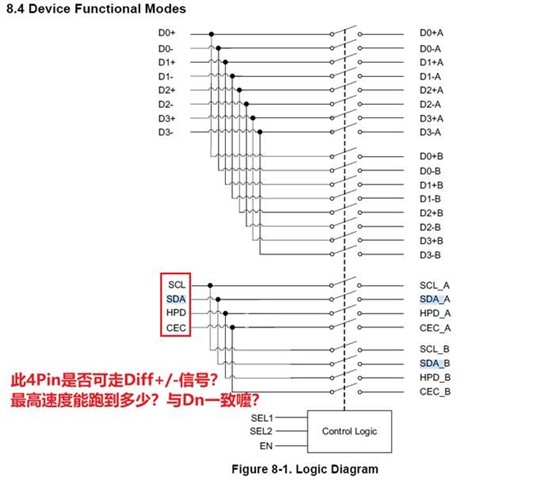

HI sir
Yes, you could I use SCL_A_B / SDA _A_B and HPD_A_B / CEC_A_B signal paths on the TS3DV642 as high speed differential signals. These paths are not different than the other signal paths in the device but are labeled differently to match up with the signals used in HDMI applications.
