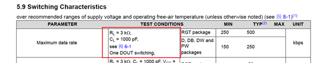

Hi Expert,
Have a good day!
I have one question about TRS3232E’s Maximum data rate.

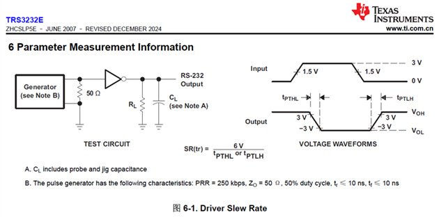

According to DS, the Maximum data rate have relationship with RL and CL.
Could you help to explain how RL, CL influence the rate?
Does it have any formulation about this ?
Thanks!
