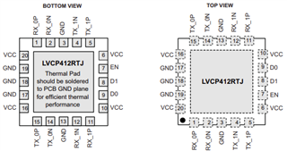

Could you please confirm there is full compatibility between the PN SN75LVCP412ARTJ and SN75LVCP412RTJ, and also with the SN75LVCP412CDRTJ ?
https://www.ti.com/compare-products/?id=657&type=GPT&mode=alternate-gpn&partList=SN75LVCP412A,SN75LVCP412,SN75LVCP412CD&sticky=true
Per the link above they are, but just want to make sure if I just can drop it in and no expect issues.
Thank you
  • Hi Said,
    SN75LVCP412 and SN75LVCP412A are p2p compatible and can be drop-in replaced. From what I can tell, 412A has enhanced ESD structures. Note that 412A is on last time buy.

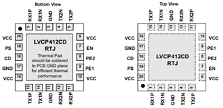

    SN75LVCP412CD is nearly p2p compatible. This device supports cable detect feature and has additional CD and PS pins. If you do not wish to use cable detect feature, both of these pins can be directly tied to GND and 412CD can be a drop-in replacement for 412.
