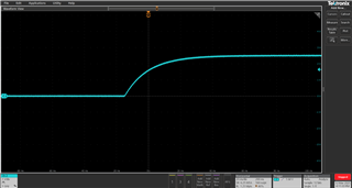

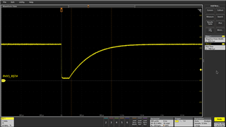

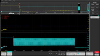

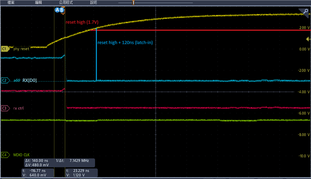

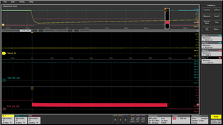

  • Attached the reset waveform for 10kohm + 0.1uF.
  • Thank you for sharing the scope capture Renfu.

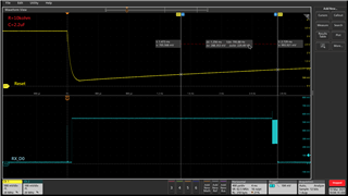

    EVM schematic is here:
    https://www.ti.com/lit/ug/snlu190/snlu190.pdf
    Test condition:
    • Add 20k to VDDIO on "RESET_N"
    • Add 2.2uF to GND on "RESET_N"
    • Press & release "S1" to pulse RESET_N to ground.
    • Read register and test link
    Thank you,
    Evan

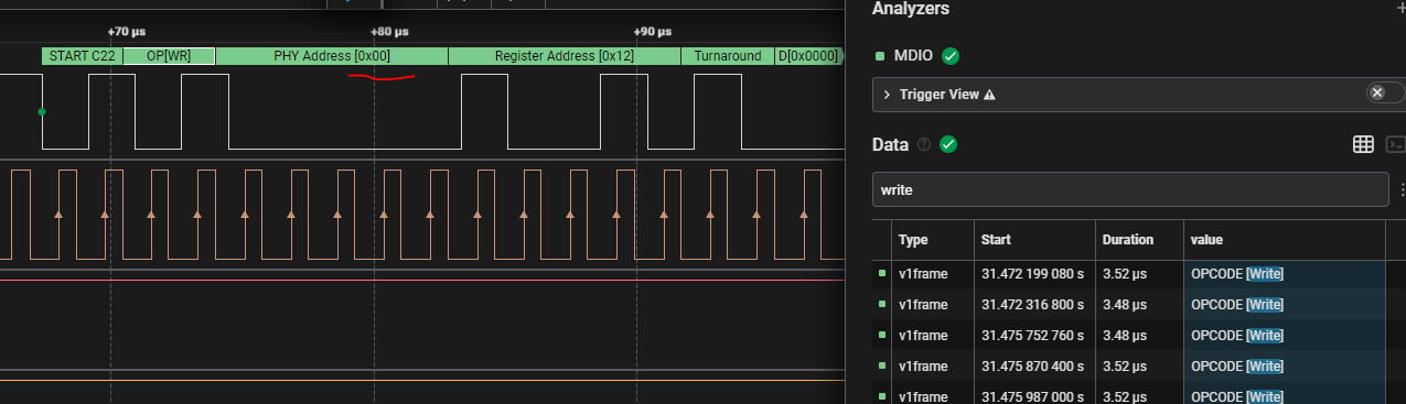

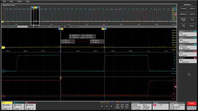

  • Hi Evan,

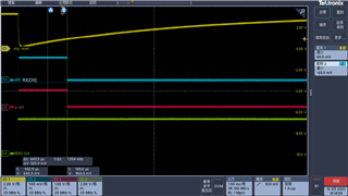

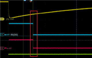

    We found that the problem may be caused when the PHY latches its address incorrectly.
    The MDIO is working fine since PHY0 (PHY Address0) is functioning properly. The following is a failure case where PHY1 (PHY Address1) does not appear on the MDIO bus.
    • PHY0 is working fine
    • PHY1 latch address timing issue (Both PHY 0 and PHY 1 consider their address to be 0)
    • PHY1 does not appear on the MDIO bus.
    Attached MDIO.cvs file contains messages on the MDIO bus
    MDIO.csv
    As we speed up the reset rise time, both PHYs operate normally. The following is the latch timing for your reference:
    • PHY1 appears on the MDIO bus.
    While speeding up the reset rise time would solve our problem, we are a little concerned whether the PHY address latch timing will meet the specifications as expected.
    Sean
  • Hi Sean,
    PHY address strap pins are the MAC RX lines. I suspect that for slower reset time, the pin state on the MAC-side changes and affects the voltage sampled on latch-in. Please confirm if MAC's RX[D0,D2,D4] pin state changes within this reset timing margin. Capturing waveforms of these lines during slow/fast reset cases can help confirm this as well.
    Thank you,
    Evan

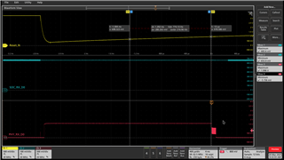

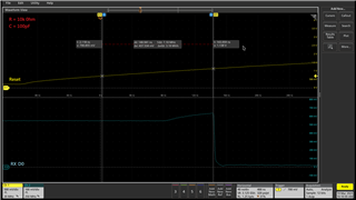

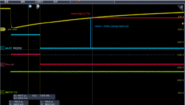

  • Hi Evan

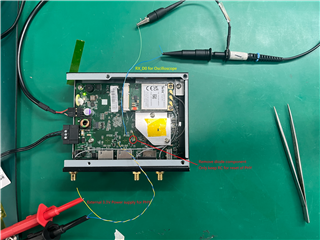

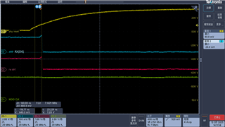

    We cannot see the issue on the EVM. Could it be because it only has one PHY and the address is set to the default value (Adrress 0) ?
    I tried to capture the waveform on MOXA/UC-2222A unit. Could you help me verify if the timing matches the specification?
    We use address 0 & address 1 on desgin , so I only catch the RX_D0 on wavefrom.
    R=10kohm and C=1uF on RESET_N
    R=10kohm and no cap. on RESET_N
  • Hi Renfu,
    Relative to my previous reply, I suspect 867EVM does not face this issue as there is no MAC connected to the RX_D[...] lines affecting the pin voltage on latch-in.
    It's possible other address straps (RX_D2/RX_D4) are affected by MAC on start-up, but this is less likely without PU/PD on these pins. Could you please share the full schematic for my review (can email to e-mayhew@ti.com for private share).
    From the waveforms shared, both PHYs look to be strapped into Address 0:
    For PHY intended for Address 1, can the MAC-side be adjusted to keep RX_D0 = 0.165 x VDDIO (Mode 2) until RESET high + 120ns?
    Thank you,
    Evan
  • Hi Evan,
    I have sent you the PHY schematic via email for your reference.
    The below picture shows that the 0.1uF capacitor has been removed for measuring purposes.
    Based on the function and protocol check, address 1 can be detected normally.
    1. Do you think there might still be a latch-in timing issue after the reset signal is released?
    2. The RX_D0 signal is controlled by the PHY after latch-in, is that correct?
  • Hi Renfu,
    I apologize, I labeled the diagram in a misleading way.
    Strap latch-in looks to occur when RESET_N(V) > VIL (0.7). This shows sample point of RX[D0] = '1' in the scopeshot with faster reset, for PHY address 0x1.
    For the slower reset case, please share a zoomed in capture of this region:
    I would like to confirm if RX_D0 is driven low before RESET_N(0.7V) + 120ns.
    1) In the slower rise time case, this is possible. I need to review failing case with faster time scale to see exact sample point.
    2) That is correct, RX_D0 will be driven by PHY after strap latch-in. Before this point, however, it's possible for other devices on the line to affect the sample voltage.

  • Hi Evan
    When R = 10k ohms and C = 2.2uF
    For a slower reset rise time, latch-in action cannot occur at the RESET_N (0.7V) + 120ns timing.
    When the reset voltage is around 1V, oscillations occur in RX_D0 during the latching process.
    When R = 10k ohms and C = 100pF
    The RX_D0 can be latched in at the RESET_N (0.7V) + 140 ns timing , address detect and PHY link function is normal.
    Reviewing the schematic, what resistor values are populated on R350 and R145 for address = 0x1?
    => R350 and R145 is not stuff , set address to 00000 ( PHY Port1 )
    => R138 pull high 10k ohm and D148 pull down 2.49k ohm , set address to 00001 ( PHY Port2 )

  • I have cut off the RX_D0 path between the SOC (MAC) and the PHY. It was found that the PHY was causing these oscillations during reset.
    Channel 2 is the SOC (MAC) RX_D0, which retains the original R138 pull-high 10kΩ resistor and the D148 pull-down 2.49kΩ resistor.
    Channel 3 is the PHY RX_D0. Due to the cut-off of the original path, I added a pull-high 10kΩ resistor to 3.3V.

  • Hi Evan
    You can find about 12.5 MHz toggle signal on RXD0
    Based on the result of cutting off the RXD0 path between the SoC (MAC) and the PHY, the toggle waveform is still present.
    Does this indicate that the noise is originating from the PHY?

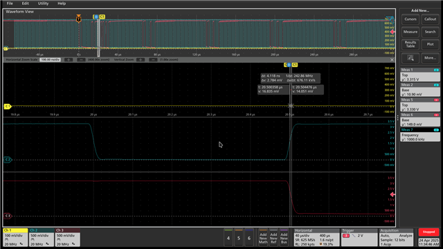

  • Hi Evan
    I’ve run a few experiments, but there are still toggle signals present on RX_D0.
    - Removed the diode (originally connecting the CPU to the PHY) , while keeping the 10kΩ resistor and 1µF capacitor on the PHY reset path only .
    - Manually generated a low pulse by briefly shorting the reset to GND.
    - Changed the PHY’s power source to an external power supply.
    The RX_D0 trace is routed between RX_D1 and RX_CLK.
    I tried shorting the RX_CLK signal to GND, but the toggle signal still persists.
    There are no high-frequency signals near the reset pin.

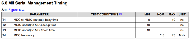

    Relating back to the original issue, I noticed some differences in MDIO waveforms in pass/fail cases:
    PHY1 no response:
    PHY1 response:
    The duty cycle and frequency appears to change between these cases. I understand we were focused on possible strapping issue due to this RX_D0 toggling, however I'd like to rule out any timing violation on SMI as well:
    In the passing/failing cases, can you please help confirm these timing requirements are being met?
    Thank you,
    Evan

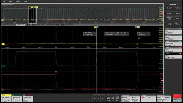

  • Hi Evan,
    I checked the MDIO signals on the failed unit.
    The timing appears to be the same regardless of whether the reset signal rises faster or slower.
    CH2: MDC
    CH3: MDIO
    Output
    Input
  • Hi Renfu,
    Thanks for sharing the data, I agree this is compliant with SMI spec.
