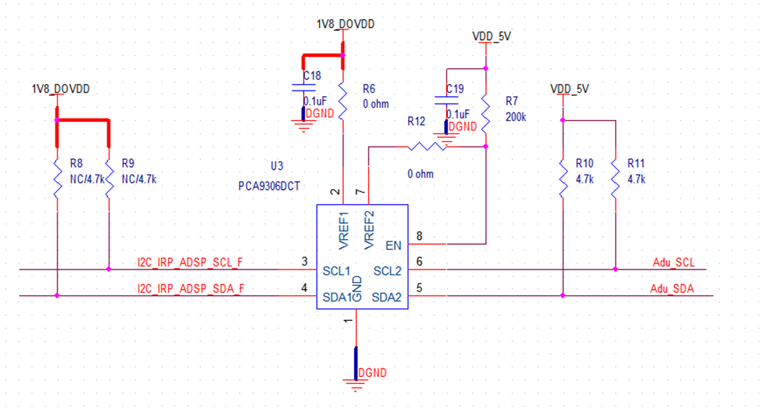

Dear TI experts,
My customer tests PCA9306 in their own PCB. Could you review the schematic first?
(1V8_DOVDD is from LDO.)
They found that if they set R7 to 200Kohm, 3.8V is detected on VREF1.
And if they set R7 to NC, 1.8V is detected on VREF1.
Could you find the reason for this symptom?
