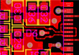

TPD1E10B06: Vertiv USB-C with FTDI issues, claims it is TVS diode issue
Part Number: TPD1E10B06
Other Parts Discussed in Thread: STRIKE, ESD122
Vertiv says that the ECF is working well with the exception being the USB interface.
 FTDI claims the TVS diodes may be the cause.
 Schematic attached and llayout for the USB C 12pin connector.
Please give opinion on the layout and schematic with the TPD1E10B06 USB-C connector.
