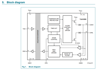

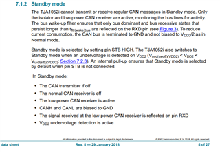

We are bidding for TJA1052IT. While customer challenge TCAN1145-Q1 doesn't support STB mode. Could you help check whether TCAN1145-Q1 support it?
If not, which TI's device can PTP to TJA1052IT?
  • Hi Beida,
    We don't have a P2P to replace TJA1052IT. TCAN1145-Q1 is a completely different device, with different pinouts and functionality.
    TJA1052IT is an isolated CAN transceiver, the only isolated CAN in our portfolio is ISO1042-Q1, which has the same functionality but different pinouts (it's 8-pin).
    If customer requires same functionality but different pinout is acceptable, ISO1042-Q1 is a good option. If they requires P2P, unfortunately we don't have.
