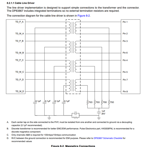

Hi All,
I have a question about DP83867.
I'm using WE-RJ45LAN as the RJ45 connector.
The WE-RJ45 LAN Transformer has a built-in center tap termination, but is it not recommended?
www.we-online.com/.../7499111446.pdf
Also, is the combination of the WE-RJ45 LAN Transformer and DP83867IR, which have separate built-in decoupling capacitors, not recommended?
www.we-online.com/.../74991114411.pdf
Which RJ45 do you recommend?
