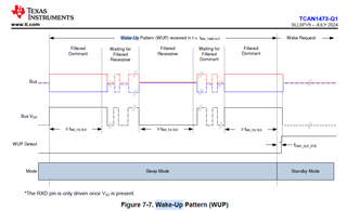

TCAN1473-Q1 has WUP mode, whether this function can disable?

Could you share more information as to why WUP needs to be disabled in this scenario?
The Wake up pattern (WUP) is part of the ISO 11898-2 standard and cannot be disabled while in Sleep mode.
However, I would look into our TCAN114X-Q1 line of devices as they have a feature called selective wake (partial networking). This can be configured in a system to wake up certain devices based on their ID.
