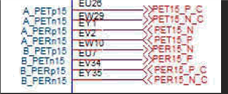

I'm using the DS160PR1601ZDGR PCIe redriver and referring to the DS320PR1601-RSC-EVM schematic. I have some questions:
1.Kindly help to check EVM U1D schematic. PCIE  PET or PER signal.   Some  P is connect to  N  or  N  is.connected to P.  Is this correct ?
    I haven't noticed this before, but this should be OK. The redriver pins do not care about the polarity of the signals they transmit or receive, so P <--> N swaps don't cause problems in the redriver and we often see customers perform these swaps to simplify trace routing on their boards. If the polarity is still inverted when the signals are routed to the endpoint or root complex, the PCIe protocol says that polarity inversions should be automatically detected and compensated by the receiver, so they should work fine on PCIe-compliant systems.
