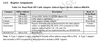

Looking at the DP159 datasheet it gives a series of definitions for the DDC Buffer ID which have sub-addresses from 0x00 to 0x22.  I can only find definitions for sub-addresses 0-0x0f in the "VESA DisplayPort Dual-Mode Standard Version 1.1a".  Are the additional sub-addresses beyond 0x0f defined in a standard? If so, which one?

    The VESA standard defines the following address space for Dual Mode DP cable adapters:
    In the DP159 datasheet, the addresses from 0x00 to 0x0F are the HDMI DDC Buffer ID codes.
    Addresses 0x10 through 0x1E are device-specific information and capabilities (Data rate, TMDS clock rate, Firmware revision, Hardware revision,...). These are all defined in the dual mode DisplayPort spec:
    Addresses 0x20 through 0x22 are feature controls for DP159. This aligns with the dual mode spec for these addresses.

    3. The TDP0604 does not have a built in Buffer ID. You will need to ignore the read of buffer ID and force HDMI output if using this part.
