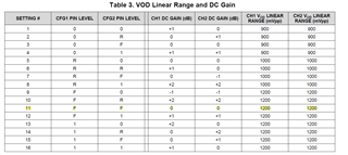

I think customer can choose EQ8 for CH1 and EQ4 for CH2, correct?
Which CFG should they select? I don't konw how to select it.
    These settings seem fine to me, I have no issue with them.
    Typically, you can leave these settings at a DC gain of 0 and a mVpp of 1200mV, so F/F. There are a few example cases where DC gain can be changed:
