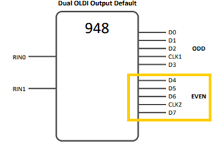

  • Hi Brent,
    These settings would be made through hardware straps (Please refer to Device Functional Modes in the datasheet).
    For the 941, please see these tables to enable number of DSI Lanes:
    For the 948, please see these tables to enable Dual OLDI output:
    For dual FPD-Link III mode, it will automatically be enabled based on the PCLK.

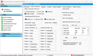

  • HI Brent,
    Can you provide a screenshot of the Pattern Generator tab on ALP that you used to program the right screen, or the script that you used to generate the screen? Thanks.
    BR,
    Esther
  • Hi Esther,
    Here is the export from the ALP, and the I2C dump for the 941 and 948.  I've tried pattern generation on the 941 and the 948.  The timing of the LCD is also attached.

  • Hi Brent,
    Thanks for the register dump and display timings.
    Just to confirm, you see missing even data when you are doing 948 PATGEN?
    Can you try to probe the D4-D7 pins and CLK2 pin on the 948 after running 948 PATGEN and see if they are outputting any video data?
    Lastly, are you using the ALP tab to enable PATGEN or running the script? The reason I'm asking is typically, we have color bars default enabled but from your picture it looks like you are just enabling Red. If we could have either a screenshot of the ALP tab you are using to program, or the script that you are running for 948 PATGEN, that would help as well.
    This is an example of the PATGEN ALP tab.
    Appreciate your patience,
    Esther

  • Hi Brent,
    Thanks for providing the context.
    I generated the 948 PATGEN script using your timings, and the values generated for the registers were the same as the ones you generated. See script attached. I connected I2C to the 941 and successfully brought up 948 PATGEN running the script. I cannot reproduce the missing even lines phenomenon you're seeing in my setup.

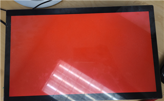

    Have you tried using the same script with a different panel? Does the phenomenon still occur?
    Have you tried using single OLDI output with the same panel (adjust MODE_SEL0 and adjust the timings so PCLK is less) and does the phenomenon still occur?
    BR,
    Esther

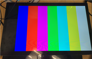

  • Thank you Esther, that helped!
    After some testing I discovered that I needed to disable DSI on the 941 and then the pattern generator on the 948 worked flawlessly.  I must have been outputting some signals on the DSI lines, causing interference with the pattern generator.  I'm now working on getting the pattern generator to work on the 941.  Using the same configuration, but changing the script so I'm targeting the 941, I'm not seeing any output.  I'll keep playing around with it, but any guidance for getting pattern generator to work for the 941?

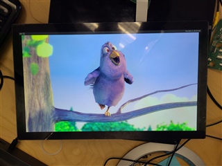

  • Hi Esther,
    Good news, it's all working now!  Part of my problem was the deserializer has some GPIOs to control the backlight and other enable pins for the LCD, and even though I would turn on the GPIOs, it seems that whenever the serializer started transmitting FPD data the deserializer would reset those GPIOs for some reason.  For now I have hardwired the enable pins so they are always on and we'll figure out a better solution for production.  Thank you again for all your help!
