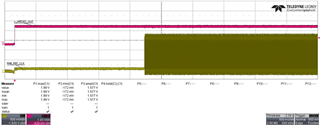

Firstly, we measured if XI is available at power ramp of VAVDD:
This picture shows the reset sequence of our SOM. VDD3V3A is connected to VAVDD and RMII_REF_CLK is connected to XI. As it can be seen the clock is not available at power ramp.

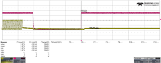

Secondly, we measured when the clock is stable in relation to our global reset-signal:
As it can be seen X_nRESET_OUT which is connected to RESET_N is not held low at least 100us after the clock is stable. RESET_N is controlled by a PMIC on our SOM, so the signal can’t be held down until the clock started because the clock is provided by the processor and the processor if affected by the reset-signal.

    This guidance in our datasheet is best practice for PHY initialization. If clock is not available at powerup and PHY is not held in reset, this could cause PHY to initialize in unknown state. Are you seeing any application issues in your validation efforts?

    Performing a pin reset at the earliest possible moment would be an effective way to mitigate if clock and reset assertion is not available immediately. Please note that this would cause device to re-strap so ensure that the strap lines are not driven at this point in time to avoid a mis-strap.

  • Hi Hamza,
    SW reset would be a decent workaround, but the concern would be if the PHY is never properly initialized, the SMI has a possibility to not come up, thereby limiting this viability. So long in your evaluation this register lockup has not occurred, this SW Reset would be safe to move forward with.
