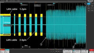

This is a measurement of pins 1-2 (yellow) and 3-6 (blue) of the LAN cable connecting our product (which contains the relevant IC) and a PC, using a FET probe. Pins 3-6 are the signal (TX) output from the DP83848-EP.
(The signal waveform is displayed in overlay.)
This waveform shows a link down that occurred several times during communication, and then did not recover.

1) Under what conditions do you think link downs like this occur that do not recover?
2) Why do the amplitudes of pins 3 and 6 increase at two points, ① and ②, after the seventh link down?

    1) There are a few possible causes for this behavior, it's difficult to isolate without more information:
    • Auto-negotiation mismatch between link partners (near side enabled vs. far side disabled, or auto-neg advertisement mismatch)
    • Poor signal quality from noise in environment
    • PHY stuck due to ESD event
    Please share the register dump for both PHYs in the link failure case, this will help isolate.
    2) I suspect this is due to auto-negotiation disabled. Forced speed modes typically have higher swing.

    2) I have not turned off auto-negotiation.
    I have forcibly turned off Auto-MDI/MDI-X.
    However, I don't think this is the cause of the problem.
    By forced speed mode, do you mean Forced Mode?
    This can be set either from the hardware AN_EN terminal or from the software register
    The specifications state that it can only be set when the power is turned on or when the device is reset.
    Looking at the symptoms, I think the cause is the software, but is that correct?

    2) Yes, I am referring to forced mode (auto-negotiation disabled, PHY set for fixed speed). This mode can be set through straps or registers. If this is not being changed through straps, I agree that possible cause is software script disabling auto-negotiation. These register dumps will help confirm this:
    Link up:
    PHY1 (848) 0x0 - 0x1F
    PHY2 (PC)  0x0 - 0x1F
    Link down (increased amplitude observed):
    If PHY2 (link partner) is from Windows PC, please refer to Eth adapter settings to confirm the port has auto-negotiation enabled. If it is running on Linux, please do share register log.
