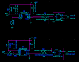

Hello.
I have a question about the wiring of THVD1420.
I want to use THDV1420 to send and receive signals from RS485.
Receive differential signals from RS485
THDV1420
Microcontroller USART RX IN
Microcontroller USART TX OUT
THDV1420
Send differential signals to RS485
I tried drawing a wiring diagram, but I don't know if this wiring diagram will work properly. This time I will use two THDV1420 for receiving and transmitting, but is it okay to leave the D of the receiving THDV1420 floating? Also, I will not use the R of the transmitting THDV1420, but is it necessary to connect the 3.3V and R25 10K resistors?
