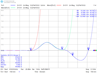

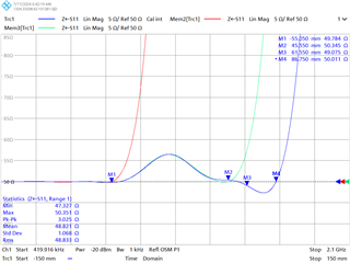

    2. about TDR, please check the waveforms and setup below:
    connect CAMERA(serializer) to VNA via SMA cable:
    connect ECU(deserializer)  to VNA via SMA cable:
    Xiaowei Zhang
  • Hi Xiaowei,
    The recommendation for S22 comes to identify if there is impedance discontinuity at one end of the cable in specific.
    In the TDR measurements, the impedance exceed 55ohms on the camera and deserializer side at similar points. Is this identified to be the connector region? From a channel specification perspective this recommendations are for the PCB traces to be impedance matched to 50Ohm +/-10%.
